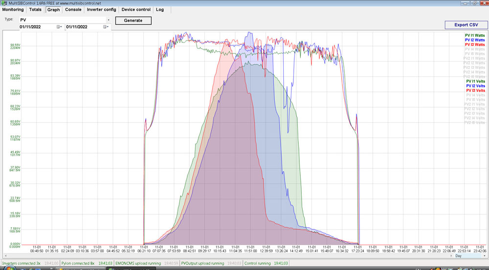

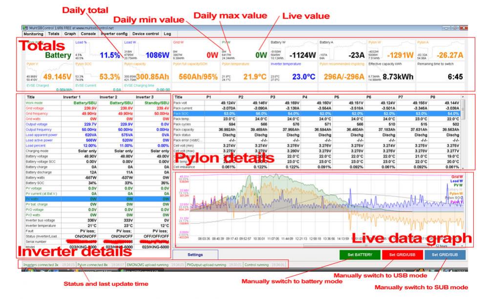

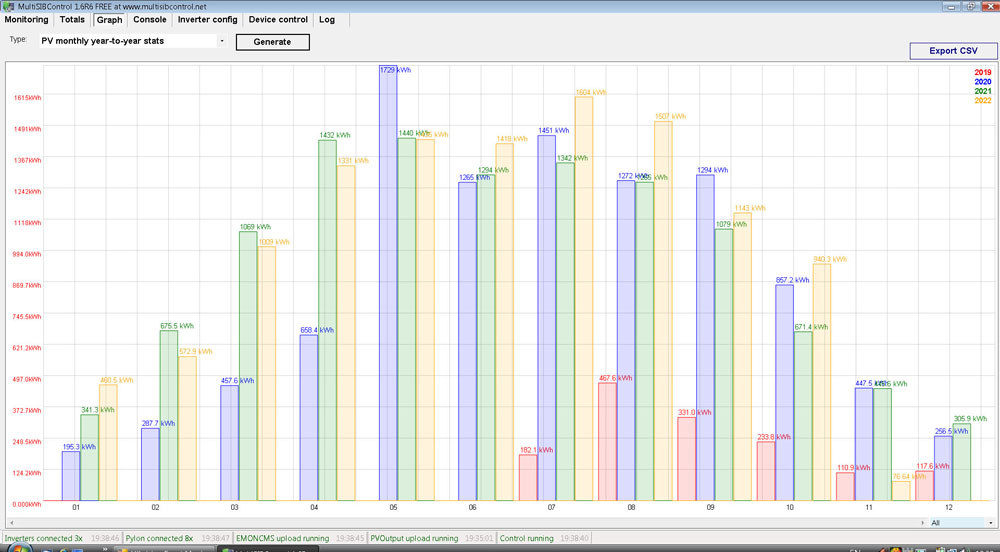

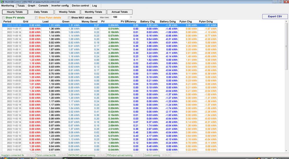

Aqui hay un software gratis...
MultiSIBControl is a software tool for monitoring and control of PIP/Axpert inverters and Pylontech batteries.
MultiSIBControl 1.8 is available for download. Please everyone update to the latest version as older versions will expire on 31/12/2023!!!
Este es el enlace: http://www.multisibcontrol.net/ .
MultiSIBControl - Monitoring an dcontrol for Axpert, PIP, Pylontech, Pylon, PIP4048, PIP5048, Voltronic
MultiSIBControl software offers the following functionality:
- read and display data from one or multiple/parallel PIP/Axpert/Infinisolar/Voltronic (and compatible) solar inverters using USB or RS232 communication
- read and display data from Pylontech batteries using RS485 or RS232 console (preferred as it supplies more data with better precision)
- handle 2 separate stacks of Pylontech batteries (up to 2x16 units) without need of HUB
- control inverter work mode based on time schedule
- control inverter work mode based on Pylontech SOC
- control inverter work mode based on custom conditions (in Device control)
- control inverter charge mode based on time schedule
- control inverter max charging current based on Pylontech BMS data
- control web/ip devices (by sending web requests) based on custom conditions (in Device control)
- send notifications to your mobile phone by using web push notifications service (in Device control)
- read and display data from web/ip devices. Currently possible to read data from OpenEVSE, Shelly EM and Shelly 1PM
- send data to emoncms server
- send data to PVOutput
- store RAW live data from inverters/batteries into database and generate reports (2-4GB of disk space per year). Up to 10x inverters and 32x batteries.
- generate various reports using raw/hourly/daily/monthly/annual data from the database
- export CSV data
- local web server for live data monitoring and control of inverters' mode
- ability to pull live data from other apps/tools using the local web server
Requirements:
- A computer that runs Windows XP, Windows Vista, Windows 7 (32/64), Windows 8/8.1, Windows 10, Windows 11
- Microsoft .NET Framework Version 3.5 (or a newer version). Free, available from www.microsoft.com.
- USB or serial inverter connection cable
- RS232/console and/or RS485 Pylontech connection cable
- Approximately 2GB storage space per year for the database
- 1.5GHz CPU and better recommended .
