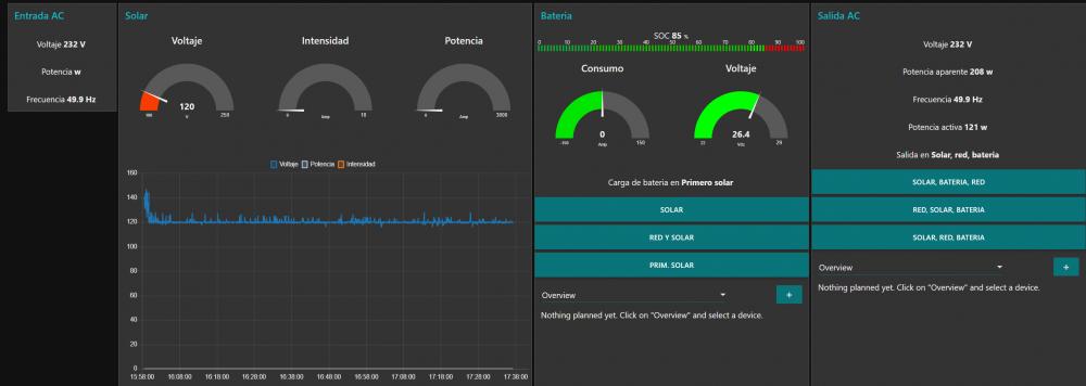

Estaba usando lo que publicaste en el hilo de RS232 RJ45 para conectarlo, y acabo de terminar esto después de 3 horas investigando y estudiando codigo. Jejejejejejeje. No hay nada como saber.
Código HTML:
[{"id":"43f193be.a46afc","type":"tab","label":"DashboarVMIII","disabled":false,"info":""},{"id":"97242079.33461","type":"ui_switch","z":"43f193be.a46afc","name":"Carga solar","label":"Carga solar","tooltip":"","group":"41484e55.2483a","order":0,"width":0,"height":0,"passthru":true,"decouple":"false","topic":"Modo Carga Baterias","style":"","onvalue":"PCP03","onvalueType":"str","onicon":"","oncolor":"","offvalue":"PCP01","offvalueType":"str","officon":"","offcolor":"","x":110,"y":60,"wires":[["a10e76ef.fafe98"]]},{"id":"a10e76ef.fafe98","type":"link out","z":"43f193be.a46afc","name":"AOtrosFlows","links":["eb901e68.0fc9"],"x":290,"y":60,"wires":[],"l":true},{"id":"187817e4.2b7408","type":"ui_text","z":"43f193be.a46afc","group":"41484e55.2483a","order":1,"width":0,"height":0,"name":"","label":"Carga de bateria","format":"{{msg.payload.prioridadcargadorbatconf}}","layout":"row-spread","x":450,"y":120,"wires":[]},{"id":"223d05fa.6abc5a","type":"link in","z":"43f193be.a46afc","name":"DeOtrosFlows","links":["91a797cc.4d1e58"],"x":110,"y":120,"wires":[["ae3aab69.5c1248"]],"l":true},{"id":"ae3aab69.5c1248","type":"function","z":"43f193be.a46afc","name":"","func":"var output = msg.payload.prioridadcargadorbatconf\nlet batstatus =\"\"\nif (output==\"1\"){\n batstatus = \"Utility\";\n}\nelse if(output==\"3\"){\n batstatus = \"Solar\";\n}\nreturn [\n {\n payload: {\n prioridadcargadorbatconf: batstatus\n }\n }\n]","outputs":1,"noerr":0,"x":270,"y":120,"wires":[["187817e4.2b7408"]]},{"id":"41484e55.2483a","type":"ui_group","z":"","name":"Parametros","tab":"87e6f9e9.429d98","order":2,"disp":true,"width":"6","collapse":false},{"id":"87e6f9e9.429d98","type":"ui_tab","z":"","name":"VMIII","icon":"dashboard","disabled":false,"hidden":false}]

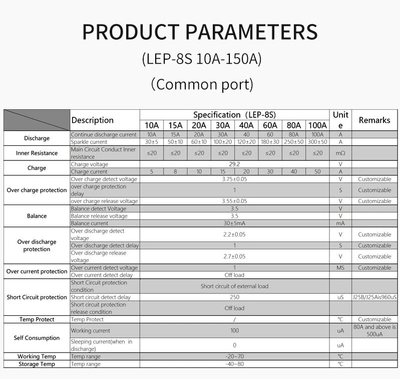

El que pone las condiciones es el BMS. Tienes datos del BMS?? sabes como sacarlos??
Date cuenta que el hibrido hara lo que quieres que haga en funcion de los datos que de el BMS.
La parte del hibrido es facil de hacer pero hace falta saber cuando tiene que hacerlo y eso es con los datos del BMS.

Aquí los datos del BMS.
Archivo adjunto 24102
Lo tengo configurado en Bulk a 28,4 cambie a batería en 27V y retorne a red a 23V.

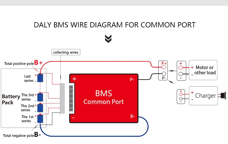

A, no. Es un BMS chino con balanceador. No tiene puerto de salida de datos.

Pues sin datos del BMS como vas a condicionar los comandos del hibrido??
Por ejemplo, si el SOC de las baterias te dice el BMS que estan al 20% y quieres pasar a modo line, como metes ese dato del 20% al flujo??

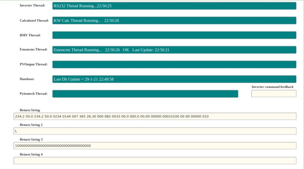

Sin embargo ICC si los coge, los tiene que tener en otro formato.
Archivo adjunto 24104
Una captura del ICC.
En esa foto no se ve nada de esos comandos... El primer string es una respuesta a un QPIGS, la segunda string es una respuesta a QMOD y la tercera string no se lo que es.
De todas formas ICC calcula esos datos de forma interna.... no creo que los pille del hibrido.
Por ejemplo, si el SOC de las baterías te dice el BMS que están al 20% y quieres pasar a modo line, como metes ese dato del 20% al flujo??

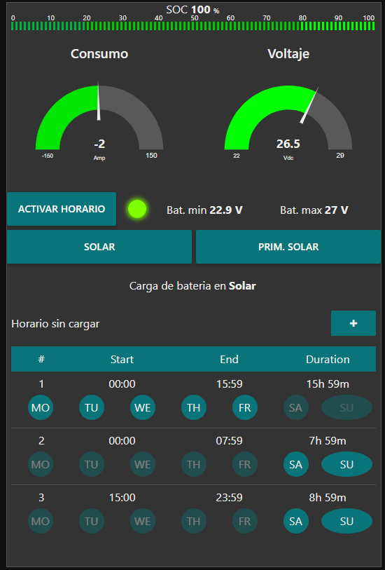

Eso es lo que estoy intentando hacer ahora. Por ahora ye he puesto un interruptor y un horario y por ahora funciona. Estoy terminando el dashboard y configurando cosas mientras lo hago. Va lento. Es la primera vez que hago esto.
Con estos parámetros de las baterías y del BMS son con los que he parametrizado por ahora el hibrido.
Archivo adjunto 24105

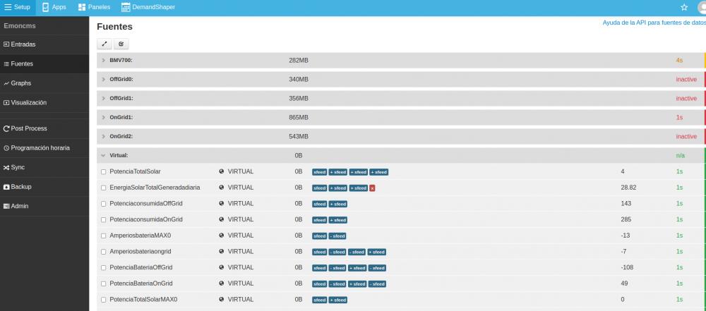

Lo ideal seria que el BMS mandara datos a la Rpi (SOC, voltajes y amperios). No te va a quedar mas remedio que calcular el SOC en la Rpi en base a los voltajes y amperios que entran y salen de las baterias. O bien fiarte del SOC que da el hibrido pero ese va en funcion solo del voltaje y no es nada preciso.
Para un balance correcto tendrias que sacar la potencia hacia baterias (amperioscargabatxVbat) y la potencia desde baterias (amperiosdescargabatxVbat) Hacer un timeseries y asi por lo menos tener un SOC muy aproximado en el tiempo para usarlo en la automatizacion del hibrido.

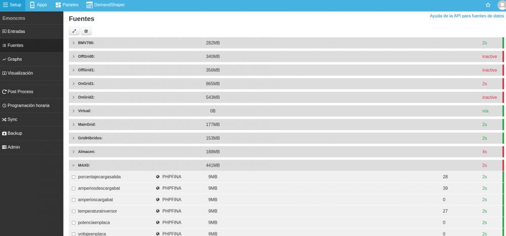

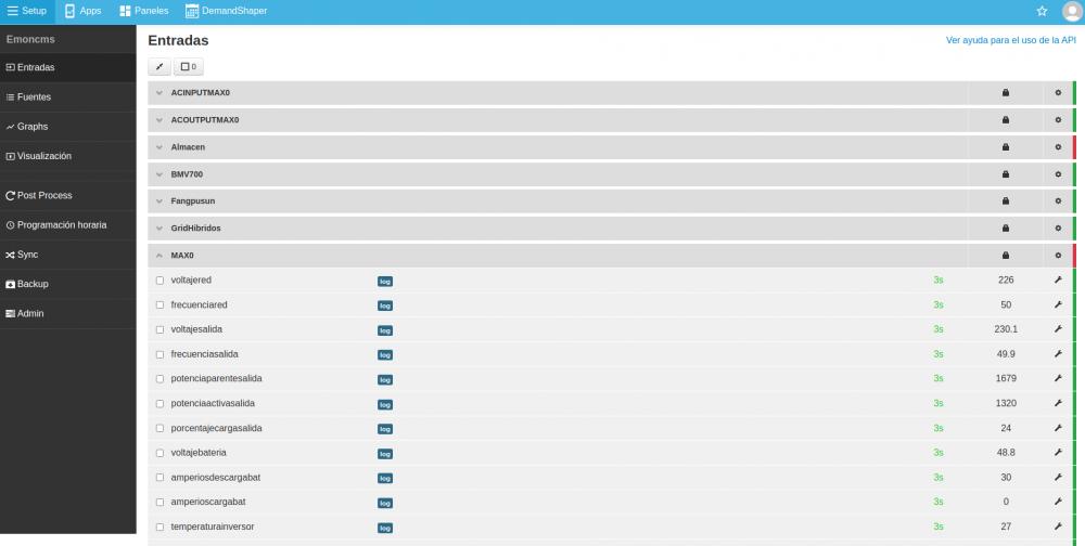

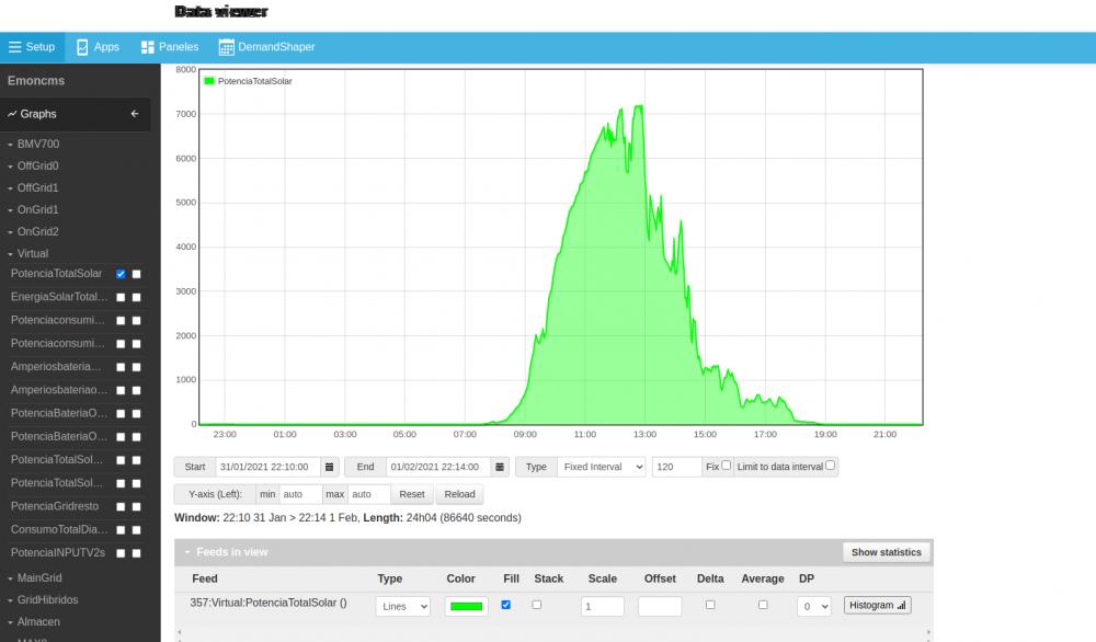

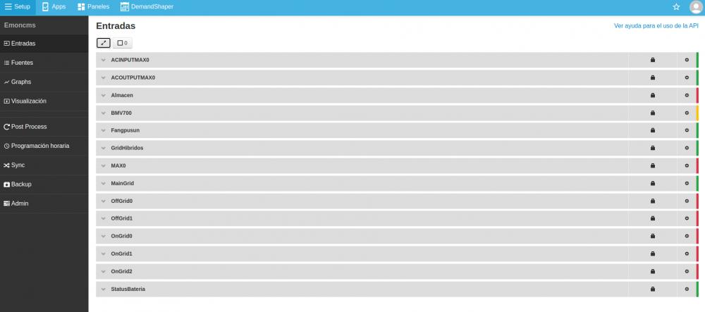

Si en el dashboard vas a meter graficas timeseries te recomiendo que instales emoncms... gestiona muy bien los datos procedentes de nodered y despues puedes meter las graficas en los dashboard con iframe.
Por ejemplo, esto es un dashboard de nodered con grafica de emoncms por timeseries incrustada con iframe en un nodo ui_template.
El UI_TEMPLATE tendria este codigo dentro del flujo del dashboard usado:
Código HTML:
[{"id":"5b6d961.d37ec68","type":"ui_template","z":"f6f2187d.f17ca8","group":"f1976897.ed7818","name":"I-V BMV700","order":2,"width":0,"height":0,"format":"<iframe id='sociv' style='width:1200px; height:500px;' frameborder='0' scrolling='no' marginheight='0' marginwidth='0' src='https://internetdemiscosas.es/emoncms/dashboard/view/sociv'></iframe>","storeOutMessages":true,"fwdInMessages":true,"resendOnRefresh":true,"templateScope":"local","x":1210,"y":80,"wires":[[]]},{"id":"f1976897.ed7818","type":"ui_group","z":"","name":"Datos BMV700","tab":"84439381.6a9b1","order":2,"disp":false,"width":23,"collapse":false},{"id":"84439381.6a9b1","type":"ui_tab","z":"","name":"Baterias","icon":"dashboard","order":2,"disabled":false,"hidden":false}]
Seria la grafica I-V-SOC del algoritmo de carga procedente del emoncms y encajada a 1200x500 pixeles.
https://tejota.net/media/k2/images/S...redemoncms.png
Instalar el emoncms no es sencillo.... aunque han puesto scripts para instalar solo las partes necesarias ... invita un poco a duda.

Buenas.
Lo que he echo hasta ahora.
Archivo adjunto 24115
Archivo adjunto 24114
He conseguido meter en horario los cambios de carga de batería y de salida AC.
Ahora me falta el poder forzar las baterías a cargar por debajo de cierta carga estando en solo solar y buscar como calcular el SOC para realizarlo con el. El que da el hibrido, como me comento Tejota, no es muy fiable. Me estuve fijando y da unos saltos muy grandes.
Os pongo el de la batería por si queréis echarle un vistazo.
Código HTML:
[{"id":"a10e76ef.fafe98","type":"link out","z":"43f193be.a46afc","name":"De dashboard","links":["11ec8945.405447"],"x":1335,"y":400,"wires":[]},{"id":"187817e4.2b7408","type":"ui_text","z":"43f193be.a46afc","group":"41484e55.2483a","order":10,"width":0,"height":0,"name":"","label":"Carga de bateria en","format":"{{msg.payload.prioridadcargadorbatconf}}","layout":"row-center","x":560,"y":100,"wires":[]},{"id":"223d05fa.6abc5a","type":"link in","z":"43f193be.a46afc","name":"A dashboard","links":["e12ad3f.350e43"],"x":135,"y":220,"wires":[["ae3aab69.5c1248","647a5df1.53c014","48797279.302a3c","15d52ff0.0e53e","6467aa99.076674","949f0d46.262a7"]]},{"id":"ae3aab69.5c1248","type":"function","z":"43f193be.a46afc","name":"Modo de carga de bateria","func":"var output = msg.payload.prioridadcargadorbatconf\nlet batstatus =\"\"\nif (output==\"1\"){\n batstatus = \"Primero solar\";\n}\nelse if(output==\"3\"){\n batstatus = \"Solar\";\n}else {\n batstatus = \"Red y solar\"\n}\nreturn [\n {\n payload: {\n prioridadcargadorbatconf: batstatus\n }\n }\n]","outputs":1,"noerr":0,"x":340,"y":100,"wires":[["187817e4.2b7408"]]},{"id":"647a5df1.53c014","type":"ui_gauge","z":"43f193be.a46afc","name":"VoltBat","group":"41484e55.2483a","order":3,"width":5,"height":4,"gtype":"gage","title":"Voltaje","label":" Vdc","format":"{{msg.payload.voltajebateria}}","min":"22","max":"29","colors":["#ffff00","#00ff00","#ff0000"],"seg1":"24,3","seg2":"27","x":290,"y":140,"wires":[]},{"id":"48797279.302a3c","type":"function","z":"43f193be.a46afc","name":"Intensidad de bateria","func":"var carga =parseFloat(msg.payload.amperioscargabat)\nvar descarga = parseFloat(msg.payload.amperiosdescargabat)\nvar voltbat=parseFloat(msg.payload.voltajebateria)\nlet ampbat =0\nlet potbat=0\nif(carga>0){\n ampbat=carga;\n}else if (descarga>0){\n ampbat =-descarga;\n}\npotbat=parseFloat(ampbat*voltbat).toFixed(1);\n\nreturn [\n {\n payload: {\n ampbat: ampbat,\n potbat: potbat\n }\n }\n]","outputs":1,"noerr":0,"x":320,"y":300,"wires":[["f8395019.cac18","67580814.c03758"]]},{"id":"f8395019.cac18","type":"ui_gauge","z":"43f193be.a46afc","name":"Consumo de bateria","group":"41484e55.2483a","order":2,"width":5,"height":4,"gtype":"gage","title":"Consumo ","label":"Amp","format":"{{msg.payload.ampbat}}","min":"-150","max":"150","colors":["#ff0000","#00e600","#ff0000"],"seg1":"-30","seg2":"30","x":560,"y":280,"wires":[]},{"id":"cafc4f0c.c87d8","type":"file","z":"43f193be.a46afc","name":"WriteFile","filename":"/home/pi/Documents/thorariobateria.txt","appendNewline":true,"createDir":true,"overwriteFile":"true","encoding":"none","x":1040,"y":340,"wires":[[]]},{"id":"71f78df9.350574","type":"inject","z":"43f193be.a46afc","name":"","topic":"","payload":"","payloadType":"date","repeat":"","crontab":"","once":true,"onceDelay":"5","x":270,"y":400,"wires":[["5620b7db.0030a8","f5d30544.d85748"]]},{"id":"5620b7db.0030a8","type":"file in","z":"43f193be.a46afc","name":"ReadFile","filename":"/home/pi/Documents/thorariobateria.txt","format":"utf8","chunk":false,"sendError":false,"encoding":"none","x":500,"y":400,"wires":[["374bd03f.e686"]]},{"id":"15d52ff0.0e53e","type":"ui_level","z":"43f193be.a46afc","group":"41484e55.2483a","order":1,"width":0,"height":0,"name":"","label":"SOC","colorHi":"#00ff00","colorWarn":"#00c800","colorNormal":"#00b33c","colorOff":"#ff0000","min":0,"max":100,"segWarn":"20","segHigh":"80","unit":"%","layout":"sh","channelA":"","channelB":"","decimals":0,"animations":"rocket","shape":"3","colorschema":"fixed","textoptions":"default","colorText":"#eeeeee","fontLabel":"","fontValue":"","fontSmall":"1","colorFromTheme":true,"textAnimations":true,"hideValue":false,"tickmode":"auto","peakmode":false,"property":"payload.capacidadbateria","peaktime":3000,"x":270,"y":220,"wires":[]},{"id":"fcc8795b.648f88","type":"ui_button","z":"43f193be.a46afc","name":"Carga solar","group":"41484e55.2483a","order":8,"width":5,"height":1,"passthru":true,"label":"Solar","tooltip":"","color":"","bgcolor":"","icon":"","payload":"PCP03","payloadType":"str","topic":"","x":1230,"y":440,"wires":[["a10e76ef.fafe98"]]},{"id":"8424095c.481c68","type":"ui_button","z":"43f193be.a46afc","name":"Prim. solar","group":"41484e55.2483a","order":9,"width":5,"height":1,"passthru":true,"label":"Prim. solar","tooltip":"","color":"","bgcolor":"","icon":"","payload":"PCP01","payloadType":"str","topic":"","x":1230,"y":380,"wires":[["a10e76ef.fafe98"]]},{"id":"374bd03f.e686","type":"ui_time_scheduler","z":"43f193be.a46afc","group":"41484e55.2483a","name":"","startDay":"1","refresh":60,"devices":["Horario sin cargar"],"customPayload":false,"eventMode":false,"sendTopic":true,"outputs":2,"order":11,"width":10,"height":3,"x":710,"y":400,"wires":[["cafc4f0c.c87d8"],["8690a11d.e9ca6","a10a45b5.d6cc58"]]},{"id":"8690a11d.e9ca6","type":"and-gate","z":"43f193be.a46afc","name":"","rules":[{"t":"true","propertyType":"msg","property":"payload","topic":"Horario sin cargar"},{"t":"true","propertyType":"msg","property":"payload","topic":"horario"}],"outputTopic":"","gateType":"and","emitOnlyIfTrue":true,"x":1060,"y":440,"wires":[["fcc8795b.648f88"]]},{"id":"a10a45b5.d6cc58","type":"and-gate","z":"43f193be.a46afc","name":"","rules":[{"t":"false","propertyType":"msg","property":"payload","topic":"Horario sin cargar"},{"t":"true","propertyType":"msg","property":"payload","topic":"horario"}],"outputTopic":"","gateType":"and","emitOnlyIfTrue":true,"x":1060,"y":380,"wires":[["8424095c.481c68"]]},{"id":"f4a029f.c2323d8","type":"ui_led","z":"43f193be.a46afc","order":5,"group":"41484e55.2483a","width":1,"height":1,"label":"","labelPlacement":"right","labelAlignment":"center","colorForValue":[{"color":"#ff4500","value":"false","valueType":"bool"},{"color":"#7fff00","value":"true","valueType":"bool"}],"allowColorForValueInMessage":false,"shape":"circle","showGlow":true,"name":"Horario","x":960,"y":500,"wires":[]},{"id":"67580814.c03758","type":"ui_gauge","z":"43f193be.a46afc","name":"Potencia de bateria","group":"1d224e25.325d02","order":4,"width":5,"height":4,"gtype":"gage","title":"Potencia Bat.","label":"w","format":"{{msg.payload.potbat}}","min":"-3000","max":"3000","colors":["#ff0000","#00e600","#ff0000"],"seg1":"-1500","seg2":"1500","x":550,"y":320,"wires":[]},{"id":"6467aa99.076674","type":"ui_level","z":"43f193be.a46afc","group":"1d224e25.325d02","order":3,"width":2,"height":9,"name":"","label":"SOC","colorHi":"#00ff00","colorWarn":"#00c800","colorNormal":"#00b33c","colorOff":"#ff0000","min":0,"max":100,"segWarn":"20","segHigh":"80","unit":"%","layout":"sv","channelA":"","channelB":"","decimals":0,"animations":"rocket","shape":"3","colorschema":"fixed","textoptions":"default","colorText":"#eeeeee","fontLabel":"","fontValue":"","fontSmall":"1","colorFromTheme":true,"textAnimations":true,"hideValue":false,"tickmode":"auto","peakmode":false,"property":"payload.capacidadbateria","peaktime":3000,"x":270,"y":260,"wires":[]},{"id":"4131721b.61411c","type":"change","z":"43f193be.a46afc","name":"","rules":[{"t":"set","p":"max","pt":"flow","to":"payload","tot":"msg"}],"action":"","property":"","from":"","to":"","reg":false,"x":830,"y":140,"wires":[["d497e503.edefd8"]]},{"id":"35cd0f86.dc2ce","type":"ui_text","z":"43f193be.a46afc","group":"41484e55.2483a","order":7,"width":3,"height":1,"name":"value max","label":"Bat. max","format":"{{msg.payload}} V","layout":"row-left","x":1200,"y":160,"wires":[]},{"id":"60bb83c5.a3b36c","type":"switch","z":"43f193be.a46afc","name":"Desvio a Max Min","property":"payload","propertyType":"msg","rules":[{"t":"gt","v":"max","vt":"flow"},{"t":"lt","v":"min","vt":"flow"}],"checkall":"true","repair":false,"outputs":2,"x":640,"y":180,"wires":[["4131721b.61411c"],["65dd8da4.7d84f4"]]},{"id":"d497e503.edefd8","type":"function","z":"43f193be.a46afc","name":"Si es mayor..","func":"if(msg.payload == -17)\n{\n msg.payload = \"-\"\n}else\n{\n msg.payload = msg.payload \n}\nreturn msg;","outputs":1,"noerr":0,"x":990,"y":140,"wires":[["35cd0f86.dc2ce","bb0fdfa1.68bbf"]]},{"id":"65dd8da4.7d84f4","type":"change","z":"43f193be.a46afc","name":"","rules":[{"t":"set","p":"min","pt":"flow","to":"payload","tot":"msg"}],"action":"","property":"","from":"","to":"","reg":false,"x":830,"y":220,"wires":[["769b3ba.d1661c4"]]},{"id":"769b3ba.d1661c4","type":"function","z":"43f193be.a46afc","name":"Si es menor...","func":"if(msg.payload == 30)\n{\n msg.payload = \"-\"\n}else\n{\n msg.payload = msg.payload\n}\nreturn msg;","outputs":1,"noerr":0,"x":1000,"y":220,"wires":[["312bc111.03088e","5e084d37.7994c4"]]},{"id":"312bc111.03088e","type":"ui_text","z":"43f193be.a46afc","group":"41484e55.2483a","order":6,"width":3,"height":1,"name":"value min","label":"Bat. min","format":"{{msg.payload}} V","layout":"row-left","x":1190,"y":200,"wires":[]},{"id":"949f0d46.262a7","type":"function","z":"43f193be.a46afc","name":"Cambiar a numer","func":"\nmsg.payload = Number(msg.payload.voltajebateria);\nreturn msg;","outputs":1,"noerr":0,"x":320,"y":180,"wires":[["60bb83c5.a3b36c"]]},{"id":"f12575f3.996878","type":"file","z":"43f193be.a46afc","name":"WriteFile","filename":"/home/pi/Documents/minbat.txt","appendNewline":true,"createDir":true,"overwriteFile":"true","encoding":"none","x":1300,"y":260,"wires":[[]]},{"id":"a9c891e2.2b748","type":"file","z":"43f193be.a46afc","name":"WriteFile","filename":"/home/pi/Documents/maxbat.txt","appendNewline":true,"createDir":true,"overwriteFile":"true","encoding":"none","x":1300,"y":100,"wires":[[]]},{"id":"bda8b751.437998","type":"file in","z":"43f193be.a46afc","name":"ReadFile","filename":"/home/pi/Documents/maxbat.txt","format":"utf8","chunk":false,"sendError":false,"encoding":"none","x":610,"y":140,"wires":[["4131721b.61411c"]]},{"id":"915a2418.d1d748","type":"file in","z":"43f193be.a46afc","name":"ReadFile","filename":"/home/pi/Documents/minbat.txt","format":"utf8","chunk":false,"sendError":false,"encoding":"none","x":610,"y":220,"wires":[["65dd8da4.7d84f4"]]},{"id":"f111d19c.8de71","type":"inject","z":"43f193be.a46afc","name":"","topic":"","payload":"","payloadType":"date","repeat":"","crontab":"","once":true,"onceDelay":0.1,"x":460,"y":140,"wires":[["bda8b751.437998","915a2418.d1d748"]]},{"id":"a96fe8bc.ac1838","type":"switch","z":"43f193be.a46afc","name":"","property":"count","propertyType":"msg","rules":[{"t":"eq","v":"1","vt":"str"},{"t":"eq","v":"2","vt":"str"}],"checkall":"true","repair":false,"outputs":2,"x":570,"y":480,"wires":[["4f5e420.f579bc"],["fedbd330.6e06a","346f5e5.bd915a2"]]},{"id":"fedbd330.6e06a","type":"change","z":"43f193be.a46afc","name":"Reset","rules":[{"t":"set","p":"reset","pt":"msg","to":"foo","tot":"str"},{"t":"delete","p":"payload","pt":"msg"}],"action":"","property":"","from":"","to":"","reg":false,"x":510,"y":520,"wires":[["fb6d1ff9.c0ae9"]]},{"id":"f5d30544.d85748","type":"ui_button","z":"43f193be.a46afc","name":"","group":"41484e55.2483a","order":4,"width":3,"height":1,"passthru":true,"label":"Activar horario","tooltip":"horario","color":"","bgcolor":"","icon":"","payload":"","payloadType":"str","topic":"horario","x":260,"y":480,"wires":[["fb6d1ff9.c0ae9"]]},{"id":"4f5e420.f579bc","type":"change","z":"43f193be.a46afc","name":"True","rules":[{"t":"set","p":"payload","pt":"msg","to":"true","tot":"bool"}],"action":"","property":"","from":"","to":"","reg":false,"x":730,"y":460,"wires":[["f4a029f.c2323d8","8690a11d.e9ca6","a10a45b5.d6cc58"]]},{"id":"346f5e5.bd915a2","type":"change","z":"43f193be.a46afc","name":"False","rules":[{"t":"set","p":"payload","pt":"msg","to":"false","tot":"bool"}],"action":"","property":"","from":"","to":"","reg":false,"x":730,"y":500,"wires":[["f4a029f.c2323d8","8690a11d.e9ca6","a10a45b5.d6cc58"]]},{"id":"fb6d1ff9.c0ae9","type":"counter","z":"43f193be.a46afc","name":"","init":"0","step":"1","lower":"","upper":"","mode":"increment","outputs":1,"x":440,"y":480,"wires":[["a96fe8bc.ac1838"]]},{"id":"5e084d37.7994c4","type":"switch","z":"43f193be.a46afc","name":"","property":"payload.voltajebateria","propertyType":"msg","rules":[{"t":"gt","v":"20","vt":"str"}],"checkall":"true","repair":false,"outputs":1,"x":1170,"y":260,"wires":[["f12575f3.996878"]]},{"id":"bb0fdfa1.68bbf","type":"switch","z":"43f193be.a46afc","name":"","property":"payload.voltajebateria","propertyType":"msg","rules":[{"t":"gt","v":"20","vt":"str"}],"checkall":"true","repair":false,"outputs":1,"x":1170,"y":100,"wires":[["a9c891e2.2b748"]]},{"id":"41484e55.2483a","type":"ui_group","z":"","name":"Bateria","tab":"cf52c41d.4312b8","order":2,"disp":false,"width":"10","collapse":false},{"id":"1d224e25.325d02","type":"ui_group","z":"","name":"Gauges","tab":"86a871b6.5aa41","order":1,"disp":false,"width":12,"collapse":false},{"id":"cf52c41d.4312b8","type":"ui_tab","z":"","name":"Bateria","icon":"dashboard","order":3,"disabled":false,"hidden":false},{"id":"86a871b6.5aa41","type":"ui_tab","z":"","name":"VMIII Home","icon":"dashboard","order":1,"disabled":false,"hidden":false}]
¿Voy bien?, me recomendáis algo.

He visto que para enviar datos a emoncms no va bien el echo de poner una salida en cada flow. He mandado los datos a un flow y de ahí he puesto solo una salida para emoncs.
5 Archivos adjunto(s)
Re: ¿Se podría mejorar la automatización de un Voltronic VMIII con node red?
restaun
Ya he corregido lo que me has dicho y lo que tenia echo en los otros flows. Lo de "cambiar numer" también lo he corregido. Es para sacar solo ese dato en esa linea. Estaba haciendo algo que ya estaba echo de antes.
A ver.... el emoncms tiene que recibir un object {} de nodered sobre un unico inputnode de emoncms. Si recibe varios objects diferentes sobre el mismo inputnode de emoncms va a haber problemas.
Lo ideal seria mandar los objects resultantes de los flujos hacia inputnodes diferentes del emoncms.
Por ejemplo. La salida de peticion de datos del hibrido (object) iria solo a los inputs del node 0 del emoncms (o del nombre que le pongamos a ese node 0 de los inputs). Los datos de cualquier otro dispositivo o flujo del nodered irian a los inputs del node 1 del emoncms y sucesivos.
Yo tengo unas cuantas inputs node diferentes en el emoncms.... cada uno corresponde a un dispositivo o proceso.
Archivo adjunto 24123
Despues cada node input tiene sus logs para hacer los feeds (fuentes)
Archivo adjunto 24124
Y asi, haces tus feeds o fuentes que es donde verdaderamente se almacenan los datos. Fijaos los tamaños de cada grupo de feeds.
Archivo adjunto 24122
Despues puedes hacer tus fuentes virtuales que son fuentes combinadas de diferentes fuentes originales de diferentes inputs para hacer algun feed especifico
Archivo adjunto 24125
Y por ultimo puedes hacer tus graficas timeseries con los feeds que quieras, ya sean nativos o virtuales:
Archivo adjunto 24126
Por eso decia que una cosa es instalar el emoncms y otra saber manejarlo para sacarle todo.
Y eso que no he dicho nada sobre los dashboard de emoncms. Esos dashboard como los dashboard de nodered son un mundo aparte. Y ambos pueden coexistir.
Este panel de potencias en dashboard emoncms es el que estoy usando actualmente incrustado en un dashboard de nodered. Tambien se ve una incrustacion de una grafica timeseries del emoncms...
https://tejota.net/media/k2/images/S...redemocnms.png
Por eso decia que integrar ambas plataformas: Node red y emoncms hacen unos dashboards muy potentes. Quizas porque estoy sacando lo mejor de ambas. Pero para gustos.... los colores....
