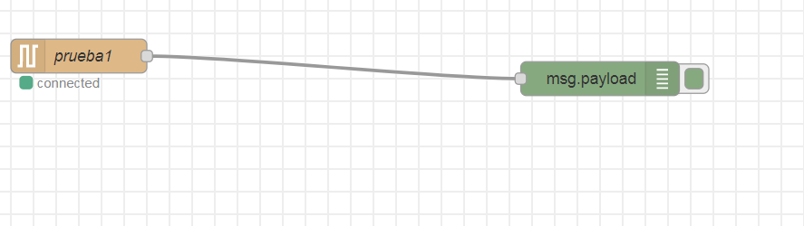

Hola muy buenas a todos. Me presento soy Gonzalo y e adquirido un Voltronic axpert vm3
os comento mi problema haber si alguien me puede ayudar. Me e comprado un cable usb a rs 232 lo conecto a mi pc
pero usando el wachpower no consigo conectar el inversor nunca leo nada. por bluetoot con la app si consigo conectarme.
E instalado node red para intentar hacer lo que vosotros haceis pero ni aun asi recibo nada en la pantalla del puerto serie.
Archivo adjunto 24686
¿alguien puede decirme que estoy haciendo mal?
Cuando solucione eso seguire intentado y ya ir depurando datos del inversor pero poco a poco
Gracias por la ayuda

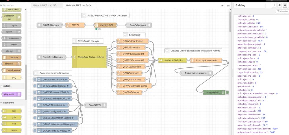

Re: [NODERED] Connection with Axperts per RJ45 serial port (PCM60X and the rest)
Hi Gonzalo
Look at the post earlier on in this topic from Tejota message #10... you need to inject some data into the inverter for it to respond.
Copy the nodered flow from this message #10 and use it to start your testing...
Archivo adjunto 24694
Código HTML:
[{"id":"19564b21.32eff5","type":"tab","label":"Voltronic MKS por Serie","disabled":false,"info":""},{"id":"d4cfefe9.02213","type":"inject","z":"19564b21.32eff5","name":"QPIRI Configuracion","props":[{"p":"payload"},{"p":"topic","vt":"str"}],"repeat":"7","crontab":"","once":false,"onceDelay":0.1,"topic":"Configuracion","payload":"QPIRI","payloadType":"str","x":160,"y":700,"wires":[["cd3d2ac7.1d46a8"]]},{"id":"d9f62829.05de08","type":"inject","z":"19564b21.32eff5","name":"QFLAG Miscelanea","props":[{"p":"payload"},{"p":"topic","vt":"str"}],"repeat":"7","crontab":"","once":false,"onceDelay":0.1,"topic":"Miscelanea","payload":"QFLAG","payloadType":"str","x":160,"y":660,"wires":[["cd3d2ac7.1d46a8"]]},{"id":"2d7e0c41.621c44","type":"inject","z":"19564b21.32eff5","name":"QBEQI Ecualizacion Bateria","props":[{"p":"payload"},{"p":"topic","vt":"str"}],"repeat":"60","crontab":"","once":false,"onceDelay":0.1,"topic":"Ecualizacion Bateria","payload":"QBEQI","payloadType":"str","x":190,"y":740,"wires":[["cd3d2ac7.1d46a8"]]},{"id":"5ecd3155.2c11b","type":"inject","z":"19564b21.32eff5","name":"QPIWS Informacion Warnings","props":[{"p":"payload"},{"p":"topic","vt":"str"}],"repeat":"5","crontab":"","once":false,"onceDelay":0.1,"topic":"Informacion Warnings","payload":"QPIWS","payloadType":"str","x":190,"y":780,"wires":[["cd3d2ac7.1d46a8"]]},{"id":"61b5f624.ac2ff8","type":"inject","z":"19564b21.32eff5","name":"QPIGS Estado General","props":[{"p":"payload"},{"p":"topic","vt":"str"}],"repeat":"4","crontab":"","once":false,"onceDelay":0.1,"topic":"Estado General","payload":"QPIGS","payloadType":"str","x":170,"y":540,"wires":[["cd3d2ac7.1d46a8"]]},{"id":"61774ebc.bdb58","type":"inject","z":"19564b21.32eff5","name":"QID Numero de Serie","props":[{"p":"payload"},{"p":"topic","vt":"str"}],"repeat":"60","crontab":"","once":false,"onceDelay":0.1,"topic":"Numero de Serie","payload":"QID","payloadType":"str","x":160,"y":500,"wires":[["cd3d2ac7.1d46a8"]]},{"id":"f2b7cde4.f8323","type":"function","z":"19564b21.32eff5","name":"CRCTJ","func":" // Algoritmo para lanzar los comandos hacia Voltronics por puerto serie con CRC propietario\n // Algoritmo realizado por Tejota [email protected]\n var topic = (msg.payload) + (\" \") + (msg.topic); // Topic con el comando string y posible descripcion\n var comandobuffer = Buffer.from(msg.payload); // pasando a buffer el string del comando \n var crc = 0x0000; // inicio del crc\n for (tj = 0; tj < comandobuffer.length; tj++) // scaneo del buffer\n {\n const byte = comandobuffer[tj]; // analizando el byte para aplicarle el crc16xmodem\n tejota = (crc >>> 8) & 0xff;\n tejota ^= byte & 0xff;\n tejota ^= tejota >>> 4;\n crc = (crc << 8) & 0xffff; // Algoritmo\n crc ^= tejota; // crc16 xmodem \n tejota = (tejota << 5) & 0xffff; // sin tabla estatica\n crc ^= tejota;\n tejota = (tejota << 7) & 0xffff;\n crc ^= tejota;\n } // resultante crc numerico \n var crchexastring = crc.toString(16).padStart(4,'0'); // crc numerico a string hexa añadiendo ceros a izquierda si es preciso\n var crchexabuffer = Buffer.from(crchexastring, \"hex\"); // buffer del crchexa\n for (mdk=0; mdk < crchexabuffer.length; mdk++) // scaneo del buffer\n {\n if (crchexabuffer[mdk]==10 || crchexabuffer[mdk]==13 || crchexabuffer[mdk]==40) // Exceptuando estos bytes mdk \n {\n crchexabuffer[mdk]++; // se pone el byte siguiente si es alguno de las excepciones mdk\n }\n } \n const retornodecarro = Buffer.from(\"\\r\");\n var crctotalbuffer = [comandobuffer, crchexabuffer, retornodecarro]; // construyendo el buffer final hacia el hibrido\n msg.payload = Buffer.concat(crctotalbuffer);\n msg.topic = topic;\n return msg;","outputs":1,"noerr":0,"initialize":"","finalize":"","x":300,"y":160,"wires":[["7545bcea.c00be4"]]},{"id":"3e8e715b.5ee93e","type":"debug","z":"19564b21.32eff5","name":"","active":true,"tosidebar":true,"console":false,"tostatus":false,"complete":"payload","targetType":"msg","statusVal":"","statusType":"auto","x":1170,"y":580,"wires":[]},{"id":"458ab114.214cc","type":"inject","z":"19564b21.32eff5","name":"QVFW Firmware CPU1","props":[{"p":"payload"},{"p":"topic","vt":"str"}],"repeat":"60","crontab":"","once":false,"onceDelay":0.1,"topic":"Version CPU1","payload":"QVFW","payloadType":"str","x":170,"y":580,"wires":[["cd3d2ac7.1d46a8"]]},{"id":"ebc28d21.a11f6","type":"inject","z":"19564b21.32eff5","name":"QVFW2 Firmware CPU2","props":[{"p":"payload"},{"p":"topic","vt":"str"}],"repeat":"60","crontab":"","once":false,"onceDelay":0.1,"topic":"Firmware CPU2","payload":"QVFW2","payloadType":"str","x":170,"y":620,"wires":[["cd3d2ac7.1d46a8"]]},{"id":"cd3d2ac7.1d46a8","type":"link out","z":"19564b21.32eff5","name":"ParaCRCTJ","links":["319f8dab.b39e82"],"x":430,"y":660,"wires":[],"l":true},{"id":"29d04a1f.362d16","type":"comment","z":"19564b21.32eff5","name":"Comandos de monitorizacion","info":"Comandos de Monitorizacion","x":160,"y":460,"wires":[]},{"id":"319f8dab.b39e82","type":"link in","z":"19564b21.32eff5","name":"CRCTJWelcome","links":["cd3d2ac7.1d46a8"],"x":140,"y":160,"wires":[["f2b7cde4.f8323"]],"l":true},{"id":"37e0fc60.268e84","type":"link out","z":"19564b21.32eff5","name":"ParaExtractores","links":["9d52fd26.2692a"],"x":700,"y":160,"wires":[],"l":true},{"id":"3853f47d.20b97c","type":"switch","z":"19564b21.32eff5","name":"Repartidor Datos Lecturas","property":"topic","propertyType":"msg","rules":[{"t":"cont","v":"QID","vt":"str"},{"t":"cont","v":"QPIGS","vt":"str"},{"t":"cont","v":"CPU1","vt":"str"},{"t":"cont","v":"QVFW2","vt":"str"},{"t":"cont","v":"QFLAG","vt":"str"},{"t":"cont","v":"QPIRI","vt":"str"},{"t":"cont","v":"QBEQI","vt":"str"},{"t":"cont","v":"QPIWS","vt":"str"},{"t":"cont","v":"QMOD","vt":"str"}],"checkall":"true","repair":false,"outputs":9,"x":390,"y":360,"wires":[["7e3afdaa.d84a14"],["352dccd5.c07ce4"],["7fe9a5f8.3302dc"],["505dc93e.025028"],["2e34f984.dd4516"],["b11d5d54.57ada"],["fb4c23a9.f5653"],["5592a1b4.8fc35"],["dcec16ee.014fd8"]]},{"id":"9d52fd26.2692a","type":"link in","z":"19564b21.32eff5","name":"ExtractoresWelcome","links":["37e0fc60.268e84"],"x":150,"y":360,"wires":[["3853f47d.20b97c"]],"l":true},{"id":"7163cfa9.53c4d","type":"comment","z":"19564b21.32eff5","name":"Repartiendo por topic","info":"","x":380,"y":260,"wires":[]},{"id":"2e34f984.dd4516","type":"function","z":"19564b21.32eff5","name":"QFLAGExtraccion","func":"var output = msg.payload.substr(1, 11);\nvar E = output.indexOf(\"E\")+1;\nvar D = output.indexOf(\"D\");\nvar enables = output.substr(E, (D-E));\nvar disables = output.substr(D+1);\nswitch (enables.includes(\"a\")){\n case true:\n buzzer = 1;\n break;\n case false: \n buzzer = 0;\n} \nswitch (enables.includes(\"b\")){\n case true:\n bypassoverload = 1;\n break;\n case false:\n bypassoverload = 0;\n break;\n} \nswitch (enables.includes(\"k\")){\n case true:\n guardapantallalcd = 1;\n break;\n case false: \n guardapantallalcd = 0;\n} \nswitch (enables.includes(\"j\")){\n case true:\n powersaving = 1;\n break;\n case false:\n powersaving = 0;\n break;\n} \nswitch (enables.includes(\"u\")){\n case true:\n overloadrestart = 1;\n break;\n case false: \n overloadrestart = 0;\n} \nswitch (enables.includes(\"v\")){\n case true:\n overtemperaturerestart = 1;\n break;\n case false:\n overtemperaturerestart = 0;\n break;\n}\nswitch (enables.includes(\"x\")){\n case true:\n luzlcd = 1;\n break;\n case false:\n luzlcd = 0;\n break;\n} \nswitch (enables.includes(\"y\")){\n case true:\n pitidosifuenteprimariafalla = 1;\n break;\n case false:\n pitidosifuenteprimariafalla = 0;\n break;\n} \nswitch (enables.includes(\"z\")){\n case true:\n grabarerrores = 1;\n break;\n case false:\n grabarerrores = 0;\n break;\n} \nreturn [\n {\n payload: {\n buzzer: buzzer,\n bypassoverload: bypassoverload,\n guardapantallalcd: guardapantallalcd,\n powersaving: powersaving,\n overloadrestart: overloadrestart,\n overtemperaturerestart: overtemperaturerestart,\n luzlcd: luzlcd,\n pitidosifuenteprimariafalla: pitidosifuenteprimariafalla,\n grabarerrores: grabarerrores,\n }\n }\n]\n","outputs":1,"noerr":0,"x":650,"y":420,"wires":[["2cb73b17.d23c34"]]},{"id":"352dccd5.c07ce4","type":"function","z":"19564b21.32eff5","name":"QPIGSExtraccion","func":"var output = msg.payload.split(\" \");\nlet voltajered = parseFloat(output[0].slice(1, 5));\nlet frecuenciared = parseFloat(output[1]);\nlet voltajesalida = parseFloat(output[2]);\nlet frecuenciasalida = parseFloat(output[3]);\nlet potenciaparentesalida = parseInt(output[4]);\nlet potenciaactivasalida = parseInt(output[5]);\nlet porcentajecargasalida = parseInt(output[6]);\nlet voltajebusalta = parseInt(output[7]);\nlet voltajebateria = parseFloat(output[8]);\nlet amperioscargabat = parseInt(output[9]);\nlet capacidadbateria = parseInt(output[10])\nlet temperaturainversor = parseInt(output[11]);\nlet amperiosenplaca = parseInt(output[12]);\nlet voltajeenplaca = parseInt(output[13]);\nlet voltajescc = parseFloat(output[14]);\nlet amperiosdescargabat = parseInt(output[15]);\nlet prioridadSBU = parseInt(output[16].slice(0,1));\nlet estadoconf = parseInt(output[16].slice(1,2));\nlet estadoscc = parseInt(output[16].slice(2,3));\nlet cargasconectadas = parseInt(output[16].slice(3,4));\nlet voltajeconstantemientrascarga = parseInt(output[16].slice(4,5));\nlet estadodecargageneral = parseInt(output[16].slice(5,6));\nlet estadodecargasolar = parseInt(output[16].slice(6,7));\nlet estadodecargared = parseInt(output[16].slice(7,9));\nlet potenciaenplaca = parseInt(output[19]);\nlet estadodelmppt = parseInt(output[20].slice(0,1));\nlet estadodelswitch = parseInt(output[20].slice(1,2));\n/*var numerodeserie = flow.get(numerodeserie);*/\nreturn [\n {\n payload: {\n voltajered: voltajered,\n frecuenciared: frecuenciared,\n voltajesalida: voltajesalida,\n frecuenciasalida: frecuenciasalida,\n potenciaparentesalida: potenciaparentesalida,\n potenciaactivasalida: potenciaactivasalida,\n porcentajecargasalida: porcentajecargasalida,\n voltajebateria: voltajebateria,\n amperiosdescargabat: amperiosdescargabat,\n amperioscargabat: amperioscargabat,\n temperaturainversor: temperaturainversor,\n potenciaenplaca: potenciaenplaca,\n voltajeenplaca: voltajeenplaca,\n estadodelmppt: estadodelmppt,\n cargasconectadas: cargasconectadas,\n voltajebusalta: voltajebusalta,\n capacidadbateria: capacidadbateria,\n amperiosenplaca: amperiosenplaca, \n voltajescc: voltajescc,\n prioridadSBU: prioridadSBU,\n estadoconf: estadoconf,\n estadoscc: estadoscc,\n voltajeconstantemientrascarga: voltajeconstantemientrascarga,\n estadodecargageneral: estadodecargageneral,\n estadodecargasolar: estadodecargasolar,\n estadodecargared: estadodecargared,\n estadodelswitch: estadodelswitch\n } ,\n/* topic: {numerodeserie: numerodeserie}*/\n }\n];","outputs":1,"noerr":0,"initialize":"","finalize":"","x":650,"y":300,"wires":[["2cb73b17.d23c34"]]},{"id":"b11d5d54.57ada","type":"function","z":"19564b21.32eff5","name":"QPIRIExtraccion","func":"var output = msg.payload.split(\" \");\nlet voltajeredconf = parseFloat((output[0].slice(1, 5)));\nlet amperiosredmaxconf = parseFloat(output[1]);\nlet voltajesalidaconf = parseFloat(output[2]);\nlet frecuenciasalidaconf = parseFloat(output[3]);\nlet amperiossalidaconf = parseFloat(output[4]);\nlet potenciaaparentesalidaconf = parseFloat(output[5]);\nlet potenciaactivasalidaconf = parseFloat(output[6]);\nlet voltajebateriaconf = parseInt(output[7]);\nlet voltajelimitedescargabatconf = parseFloat(output[8]);\nlet voltajelimiterecargabatconf = parseFloat(output[22]);\nlet voltajeminimoparacorteconf = parseFloat(output[9]);\nlet voltajeabsorcionconf = parseFloat(output[10]);\nlet voltajeflotacionconf = parseFloat(output[11]);\nlet tipodebateriaconf = parseInt(output[12]);\nlet amperiosmaxcargadorbatconf = parseInt(output[13]);\nlet amperiosmaxtotalesabatconf = parseInt(output[14]);\nlet rangovoltajedentradaconf = parseInt(output[15]);\nlet prioridadfuentesalidaconf = parseInt(output[16]);\nlet prioridadcargadorbatconf = parseInt(output[17]);\nlet maximonumeroparalelosconf = parseInt(output[18]);\nlet tipodemaquina = parseInt(output[19]);\nlet tipodehibridoconf = parseInt(output[20]);\nlet tipodesalidaparaleloconf = parseInt(output[21]);\nlet potenciasolarparaleloconf = parseInt(output[23]);\nlet potenciasolarbalanceconf = parseInt(output[24]);\nreturn [\n {\n payload: {\n voltajeredconf: voltajeredconf,\n amperiosredmaxconf: amperiosredmaxconf,\n voltajesalidaconf: voltajesalidaconf,\n frecuenciasalidaconf: frecuenciasalidaconf,\n amperiossalidaconf: amperiossalidaconf,\n potenciaaparentesalidaconf: potenciaaparentesalidaconf,\n potenciaactivasalidaconf: potenciaactivasalidaconf,\n voltajebateriaconf: voltajebateriaconf,\n voltajelimiterecargabatconf: voltajelimiterecargabatconf,\n voltajelimitedescargabatconf: voltajelimitedescargabatconf,\n voltajeminimoparacorteconf: voltajeminimoparacorteconf,\n voltajeabsorcionconf: voltajeabsorcionconf,\n voltajeflotacionconf: voltajeflotacionconf,\n tipodebateriaconf: tipodebateriaconf,\n amperiosmaxcargadorbatconf: amperiosmaxcargadorbatconf,\n amperiosmaxtotalesabatconf: amperiosmaxtotalesabatconf,\n rangovoltajedentradaconf: rangovoltajedentradaconf,\n prioridadfuentesalidaconf: prioridadfuentesalidaconf,\n prioridadcargadorbatconf: prioridadcargadorbatconf,\n maximonumeroparalelosconf: maximonumeroparalelosconf,\n tipodemaquina: tipodemaquina,\n tipodehibridoconf: tipodehibridoconf,\n tipodesalidaparaleloconf: tipodesalidaparaleloconf,\n potenciasolarparaleloconf: potenciasolarparaleloconf,\n potenciasolarbalanceconf: potenciasolarbalanceconf\n }\n }\n]","outputs":1,"noerr":0,"x":640,"y":460,"wires":[["2cb73b17.d23c34"]]},{"id":"7fe9a5f8.3302dc","type":"function","z":"19564b21.32eff5","name":"QVFW Extraccion U1","func":"var output = msg.payload;\nlet Firmware = (output.slice(10, 15));\nreturn [\n {\n payload: {\n Firmware: Firmware\n }\n }\n]","outputs":1,"noerr":0,"x":660,"y":340,"wires":[["2cb73b17.d23c34"]]},{"id":"505dc93e.025028","type":"function","z":"19564b21.32eff5","name":"QVFW2 Firmware U2","func":"var output = msg.payload;\nlet Firmware2 = (output.slice(11, 16));\nreturn [\n {\n payload: {\n Firmware2: Firmware2\n }\n }\n]","outputs":1,"noerr":0,"x":660,"y":380,"wires":[["2cb73b17.d23c34"]]},{"id":"fb4c23a9.f5653","type":"function","z":"19564b21.32eff5","name":"QBEQI Ecu Extrac","func":"var output = msg.payload.split(\" \");\nlet activacionecualizacion = parseInt(output[0].slice(1, 2));\nlet tiempoecualizacion = parseInt(output[1]);\nlet diasentreecualizaciones = parseInt(output[2]);\nlet maxamperiosparaecualizar = parseInt(output[3]);\nlet diasquefaltanparaecualizar = parseInt(output[4]);\nlet voltajedeecualizacion = parseFloat(output[5]);\nlet tiempodeabsorcion = parseInt(output[6]);\nlet timeoutecualizacion = parseInt(output[7]);\nreturn [\n {\n payload: {\n activacionecualizacion: activacionecualizacion,\n tiempoecualizacion: tiempoecualizacion,\n diasentreecualizaciones: diasentreecualizaciones,\n maxamperiosparaecualizar: maxamperiosparaecualizar,\n diasquefaltanparaecualizar: diasquefaltanparaecualizar,\n voltajedeecualizacion: voltajedeecualizacion,\n tiempodeabsorcion: tiempodeabsorcion,\n timeoutecualizacion: timeoutecualizacion\n }\n }\n]","outputs":1,"noerr":0,"initialize":"","finalize":"","x":650,"y":500,"wires":[["2cb73b17.d23c34"]]},{"id":"7e3afdaa.d84a14","type":"function","z":"19564b21.32eff5","name":"QID Nº Serie Extrac","func":"var numerodeserie = msg.payload.slice(1, 15);\nflow.set('numerodeserie', numerodeserie);\nreturn [\n {\n payload: {\n numerodeserie: numerodeserie\n }\n }\n];\n// Numero de Serie va a flow o incluso podria ir a global para identificar en paralelos ","outputs":1,"noerr":0,"initialize":"","finalize":"","x":660,"y":260,"wires":[["2cb73b17.d23c34"]]},{"id":"f25ab0ee.65fde","type":"comment","z":"19564b21.32eff5","name":"Extractores","info":"","x":670,"y":220,"wires":[]},{"id":"5592a1b4.8fc35","type":"function","z":"19564b21.32eff5","name":"QPIWS Warnings Extrac","func":"var output = msg.payload;\nlet reservado = parseInt(output.slice(1, 2));\nlet falloinversor = parseInt(output.slice(2, 3));\nlet fallo08voltajebusalto = parseInt(output.slice(3, 4));\nlet fallo52voltajebusbajo = parseInt(output.slice(4, 5));\nlet fallo09softwarebus = parseInt(output.slice(5, 6));\nlet peligronoacinput = parseFloat(output.slice(6, 7));\nlet peligrocortopv = parseInt(output.slice(7, 8));\nlet fallo58voltajeinversorbajo = parseInt(output.slice(8, 9));\nlet fallo06voltajeinversoralto = parseInt(output.slice(9, 10));\nlet peligro02sobretemperatura = parseInt(output.slice(10, 11));\nlet peligro01ventilador = parseInt(output.slice(11, 12));\nlet peligro03altovoltajebateria = parseInt(output.slice(12, 13));\nlet peligro04bajovoltajebateria = parseInt(output.slice(13, 14));\nlet peligro07sobrecargar = parseInt(output.slice(14, 15));\nlet peligrobateriashutdown = parseInt(output.slice(15, 16));\nlet peligro10bateriaderating = parseInt(output.slice(16, 17));\nlet peligroeeprom = parseInt(output.slice(17, 18));\nlet fallo51sobrecorriente = parseInt(output.slice(18, 19));\nlet fallosoftwareinversor = parseInt(output.slice(19, 20));\nlet falloautotest = parseInt(output.slice(20, 21));\nlet fallo55continuaenac = parseInt(output.slice(21, 22));\nlet fallo56bateriaabierta = parseInt(output.slice(22, 23));\nlet fallo57sensorcorriente = parseInt(output.slice(23, 24));\nlet fallocortobateria = parseInt(output.slice(24, 25));\nlet peligrolimitepotencia = parseInt(output.slice(25, 26));\nlet peligro13altovoltajeplaca = parseInt(output.slice(26, 27));\nlet fallompptsobrecarga = parseInt(output.slice(27, 28));\nlet peligro14mpptsobrecarga = parseInt(output.slice(28, 29));\nlet peligro12bateriabajaparamppt = parseInt(output.slice(29, 30));\nreturn [\n {\n payload: {\n falloinversor: falloinversor,\n fallo08voltajebusalto: fallo08voltajebusalto,\n fallo52voltajebusbajo: fallo52voltajebusbajo,\n fallo09softwarebus: fallo09softwarebus,\n peligronoacinput: peligronoacinput,\n peligrocortopv: peligrocortopv,\n fallo06voltajeinversoralto: fallo06voltajeinversoralto,\n peligro02sobretemperatura: peligro02sobretemperatura,\n peligro01ventilador: peligro01ventilador,\n peligro03altovoltajebateria: peligro03altovoltajebateria,\n peligro04bajovoltajebateria: peligro04bajovoltajebateria,\n peligro07sobrecargar: peligro07sobrecargar,\n peligrobateriashutdown: peligrobateriashutdown,\n peligro10bateriaderating: peligro10bateriaderating,\n peligroeeprom: peligroeeprom,\n fallo51sobrecorriente: fallo51sobrecorriente,\n fallosoftwareinversor: fallosoftwareinversor,\n falloautotest: falloautotest,\n fallo55continuaenac: fallo55continuaenac,\n fallo56bateriaabierta: fallo56bateriaabierta,\n fallo57sensorcorriente: fallo57sensorcorriente,\n fallocortobateria: fallocortobateria,\n peligro13altovoltajeplaca: peligro13altovoltajeplaca,\n fallompptsobrecarga: fallompptsobrecarga,\n peligro14mpptsobrecarga: peligro14mpptsobrecarga,\n peligro12bateriabajaparamppt: peligro12bateriabajaparamppt\n }\n }\n]","outputs":1,"noerr":0,"initialize":"","finalize":"","x":670,"y":540,"wires":[["2cb73b17.d23c34"]]},{"id":"2cb73b17.d23c34","type":"join","z":"19564b21.32eff5","name":"Juntando Todo 4 s","mode":"custom","build":"merged","property":"payload","propertyType":"msg","key":"topic","joiner":"\\n","joinerType":"str","accumulate":false,"timeout":"4","count":"","reduceRight":false,"reduceExp":"","reduceInit":"","reduceInitType":"","reduceFixup":"","x":910,"y":380,"wires":[["565c63f0.2649fc"]]},{"id":"ea295d26.2fccd","type":"link out","z":"19564b21.32eff5","name":"TodasLecturasHibrido","links":[],"x":1060,"y":460,"wires":[],"l":true},{"id":"4bcb3d1b.5ea574","type":"comment","z":"19564b21.32eff5","name":"Creando Objeto con todas las lecturas del Hibrido","info":"","x":1040,"y":320,"wires":[]},{"id":"565c63f0.2649fc","type":"function","z":"19564b21.32eff5","name":"Id en topic num serie","func":"var topic = flow.get('numerodeserie');\nmsg.topic = topic;\nreturn msg;","outputs":1,"noerr":0,"initialize":"","finalize":"","x":1120,"y":380,"wires":[["ea295d26.2fccd","3e8e715b.5ee93e"]]},{"id":"fc5f3dc3.947c9","type":"inject","z":"19564b21.32eff5","name":"QMOD Modo de Trabajo","props":[{"p":"payload"},{"p":"topic","vt":"str"}],"repeat":"5","crontab":"","once":false,"onceDelay":0.1,"topic":"Modo de Trabajo","payload":"QMOD","payloadType":"str","x":170,"y":820,"wires":[["cd3d2ac7.1d46a8"]]},{"id":"dcec16ee.014fd8","type":"function","z":"19564b21.32eff5","name":"QMOD Extractor","func":"var output = msg.payload;\nlet mododetrabajo = output.slice(1, 2);\nreturn [{\n payload: {\n mododetrabajo: mododetrabajo\n }\n }\n ];","outputs":1,"noerr":0,"initialize":"","finalize":"","x":640,"y":580,"wires":[["2cb73b17.d23c34"]]},{"id":"f8fed9b0.a2c708","type":"comment","z":"19564b21.32eff5","name":"RS232-USB PL2303 or FTDI Conversor","info":"","x":490,"y":100,"wires":[]},{"id":"7545bcea.c00be4","type":"serial request","z":"19564b21.32eff5","name":"","serial":"88ec1814.a229c8","x":490,"y":160,"wires":[["37e0fc60.268e84"]]},{"id":"88ec1814.a229c8","type":"serial-port","z":"","serialport":"/dev/ttyUSB0","serialbaud":"2400","databits":"8","parity":"none","stopbits":"1","waitfor":"","dtr":"none","rts":"none","cts":"none","dsr":"none","newline":"\\r","bin":"false","out":"char","addchar":"","responsetimeout":"1000"}]
