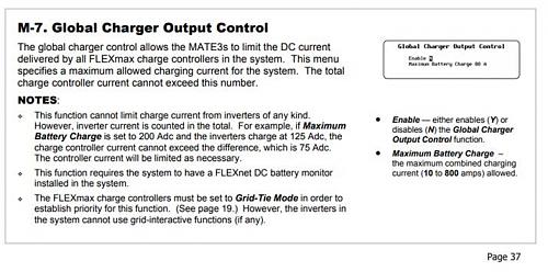

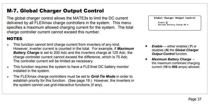

    A ver, les he preguntado a los de Outback por el mismo caso, y por lo que responden interpreto que siempre que tengas el shunt y la unidad de control (MATE3S) sí se puede limitar la corriente máxima de carga sin limitar la salida total del regulador. Os pego los emails para quien pueda interesar
    Cita Iniciado por Vtcop
    Hi! I'm trying to design my solar system and I have a doubt about your products.
    I want to combine one of your inverters and solar controllers, but I have more solar panels power than battery capacity, so the battery can NOT be charged at maximun power. I suppose I can limit the max battery current charge at solar controller. For instance, if solar panels are able to produce 80A and the recommended max charge current for my battery is 30A, and I limit battery current charge to 30A.... does the solar controller take advantage of the other 50A that solar panels could produce if the inverter has AC loads (fridge, tv...) that need this energy ???
    If not, do you have any integrated product (hybird?) which is able to do that ???
    Lot of Thanks
    Cita Iniciado por Anthony Nelson
    Hello Tomás,
    If you have a FLEXnet DC as a component in your system the MATE3s has a setting called Global Charger Output Control which allows the system to limit the amount of charging current to the batteries.
    This is a link to the FLEXnet-DC product page:
    http://www.outbackpower.com/products...ent/flexnet-dc
    Thank you,
    I'm not sure we are speaking about the same thing.
    If I set Global charger output current to 20A...
    Will the solar controller get only 20A from the panels when it could get 50A (20A for battery charging and 30A for the inverter)?
    Hello,
    The net to the battery will be limited to 20A, but the full 50A would be available for loads.
    Thank you,
    Por fin una respuesta clara
    PD: Sigo peleando con el señor de Victron, a ver si teniendo una Color Control GX en el sistema se pudiera hacer.

    Hablan de la red a la batería, no se si será lo mismo, aunque supongo que si.
    Vaya, había olvidado ese tema... a lo mejor sólo es posible si tiene las dos fuentes de energía, los panels y AC

    Sí lo hace automáticamente tiene poco sentido la opción "limit max charge current"
    ¿Tienes alguna otra instalación con otro tamaño de baterías en la que el regulador tampoco cargue las baterías al máximo que puede obtener de los paneles? ¿Estas instalaciones tiene Color Control GX?
  24. #174
    VTCop está desconectado Forero
    jul 2014
    Totana, Murcia
    150
    Predeterminado Re: Regular intensidad de carga con MPPT Bluesolar
    A ver, de mis conversiaciones con Outback y con Victron deduzco que ambos son capaces de hacerlo, de limitar la corriente de carga de la batería sin limitar la corriente absoluta de salida del regulador, siempre que estén en conjunto con un shunt y con un Color Control o MATE.
    Solar panels are able to produce 50A. Battery max current is set to 20A. There are loads of 25A.
    Will the inversor receive 25A and the battery 20A?
    I really thank your explains.
    Cita Iniciado por Johannes Boonstra, Vicron
    Yes, IF you have DVCC active on the CCGX/VenusGX
    Best regards
    Met vriendelijke groet
    Y con Outback:
    Cita Iniciado por VTcop
    Even with solar panels as only source of energy? I'm supposing I don't have any grid, neither utility nor generator.
    Is this possible (limit battery current and get the maximum of the panels) even in this case?
    Cita Iniciado por Anthony Nelson, Outback Power
    Hello,
    If your panels are capable of producing 50A, and the batteries are capable of accepting 20A. The Global Charger Control parameter being set to 20A will limit the amperage to the battery to 20A. If you have a load the production will be 20A to the battery and up to 30ADC to the load.
    Thank you,
