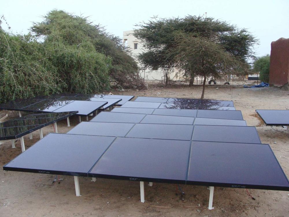

- 16/07/2012, 10:54 #30
- jun 2012
- Bilbao
